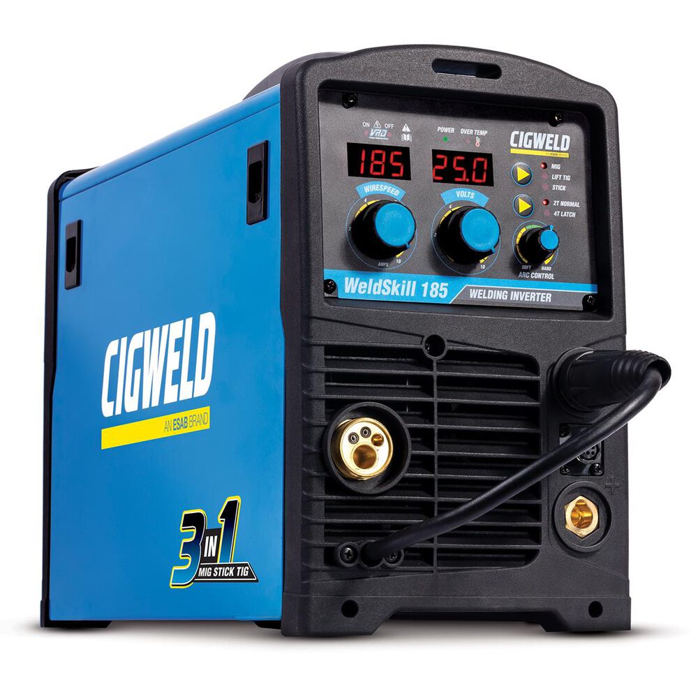

Tax year is a good time to go shopping. Bloody super-cheap are having a 30% everything sale tomorrow. This Cigweld 185 will be a smidge over $600 tomorrow..
Has a duty of 10% at full power, seem in line with other welders of it's size. Hmmmm.
