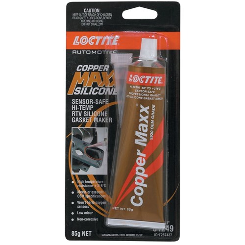

the coppermax silicon is the only thing that seems to seal the shitboxes exhaust manfolds up ..... It still eventually starts chuffing again though.
