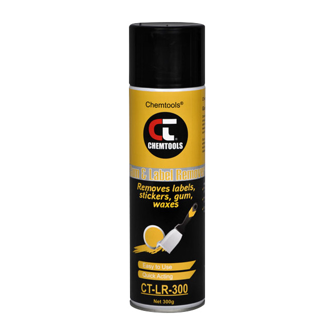

That troublesome glue comes off a little bit easier if you get your hands on some gum and sticker residue remover from say Altronics? people like that. It's badged Chemtools and does actually work even with tree sap.
There may well be other options but I have experience with this one:
And I see there's other retailers too.

Thanks for the tip on the glue remover schlitzaugen. I think at this stage my son just needs to learn to drive and control the car, and since his brother wants to come along as well we may need the rear seats. Ideally if he starts getting competetive and moves on from Motorkhana to Khanacross we will look at lightening it up.
