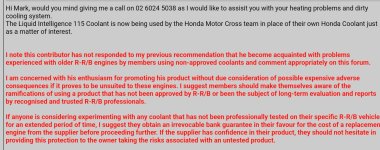

Over on the RR/Bentley forum there's bad news around using a certain brand of product with their wet liner engines.
The term 'snake oil' pops up on the Stag forum.
