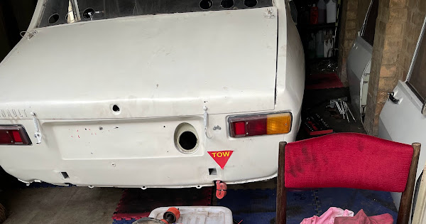

Well ignoring the steering rack for the moment, I had an afternoon to play springs.
These are annoying.
This was a real 2 hours for me, confess you had me all nervous. Here I was going slow checking the clamps after each groan in the suspension, then of course I nervously pulled the retainer rod from the upper control arm and expected everything to go "bing" but all I got was a thud and it fell and was stuck half way.
These are big springs, and this is even with ~2 coils already removed. Big as a chair and as long as an engine :p
Oh I nearly cocked up by running out of thread on the rods I had selected. Of course putting them on the springs in situ the spring was already somewhat compressed, but what about when I come to decompress... anyway I got lucky, there was enough thread for a gentle "PANG" as I got to the end of the rod. :p
But stuff putting these back on, will be investigating coil over sleeves for these Koni bodies.
Think of the weight I'll save, the coil over spring will no doubt be half the weight.
